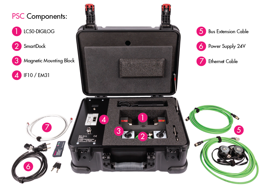

Simply mount the LC50-DIGILOG laser via the magnet bases anywhere within the machine tool workspace, connect the cable to your laptop, and then follow the step-by-step interactive instructions to start collecting spindle data. Using the cable included with the PSC allows all measurements to be performed with the machine tool doors closed, therefore ensuring the safety of the machine operator.
